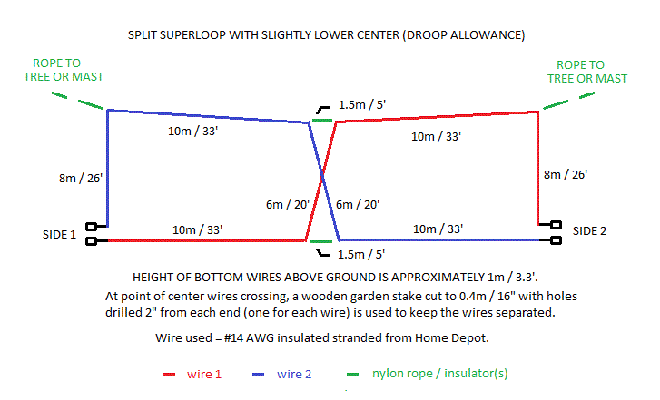

The 140 x 20 DKAZ has about 3 dB more signal than the Double Flag with 35'
loops.
If you can replace that DKAZ with the Double Flag in less than an hour,
you're a much faster builder than I. Hopefully the Double Flag or whatever
we end up calling this antenna type (assuming it works well) with also
provide you with 30 dB F/B. Please be sure to dimension it as closed to
perfect as possible.
73 KAZ

> Good to see you working on these as well, Mark. To me the most important
> goal is to see what is needed to achieve the same type of 30 dB F/B often
> available from the DKAZ. If that can be had, then two things are good,
> 1) More signal (7 dB for same footprint using rectangular loops rather
> than triangular) which will help those critical low end low signal DU's on
> DKAZ and similar low band stations.
> 2) An acceptable antenna that can fit into an 80 ft or so space which
> opens up Dual-Loop type antennas to DXers with less space.
> 73 KAZ

> The following is a variation on the Split SuperLoop design that I may
> actually be able to install and test here soon. I have attached a
> drawing. If it can't be accessed directly from the email, please see:
> http://www.qsl.net/wa1ion/pictures1/split_superloop_201709.gif
> This differs from the conventional layout in that it is designed for two
> available supports (one on each side) so some allowance needs to be made
> for droop in the center.
> Each top wire drops in height (referenced to base) from 8m / 26 ft. at the
> side supports to approximately 6m / 20 ft. at the center.
> At the crossing point of the near-center drop wires, a wooden garden stake
> cut to 0.4m / 16" with holes drilled 2" from each end (one for each wire)
> is used to keep the wires separated.
> As in the notes on the drawing:
> Wire used = #14 AWG insulated stranded THHN from Home Depot.
> Height of bottom wires above ground is approximately 1m / 3.3 ft.
> Looking at the antenna drawing as I would actually view the antenna from
> my back deck, the left (Side 1) is west and the right (Side 2) is east,
> approximately.
> I am soliciting Neil (and/or others proficient in EZNEC) to model this
> layout and see if it has merit for good F/B ratio and reasonable pest
> reduction at bearings +/- 45 deg. off max null, e.g. at least 10 dB down
> (relative to forward pick-up) at all bearings between southwest and
> northwest if the main null axis is west.
> How finicky is termination resistance and would a high band station need a
> different setting from a low band one on the same axis?
