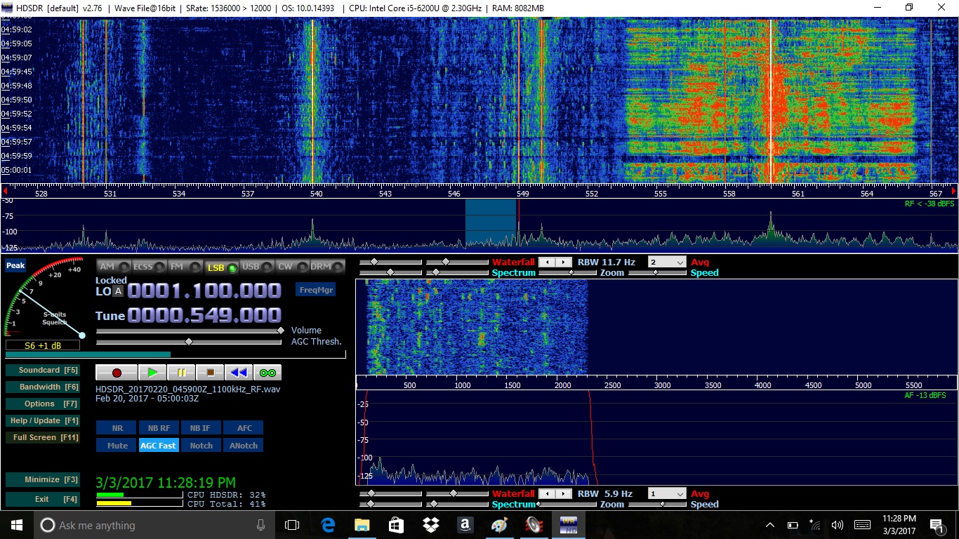

As noted on the screen shots(top of page):
http://www.qsl.net/wa1ion/pictures1/hdsdr_elad_20170220_0500z.jpg
CPU: Intel Core i5-6200U @ 2.30 GHz, RAM: 8082 MB.

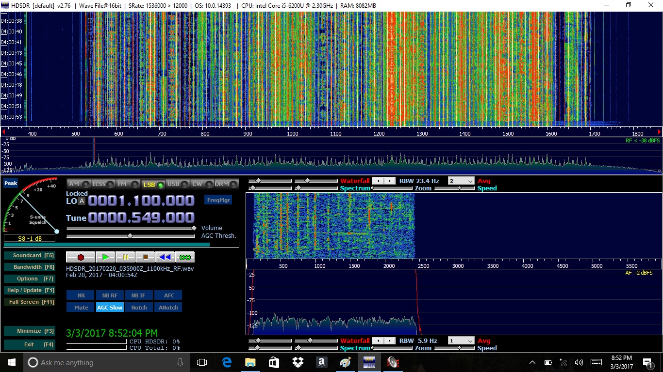

>I put up two screen shots of HDSDR running the receiver:
>http://www.qsl.net/wa1ion/pictures1/hdsdr_elad_20170220_0400z.jpg
>The first one shows the entire received spectrum, about 400-1800
>kHz, on the spectrum and waterfall plots.
>The second one has the spectrum zoomed in on a small range around
>the received frequency (Algeria 549).

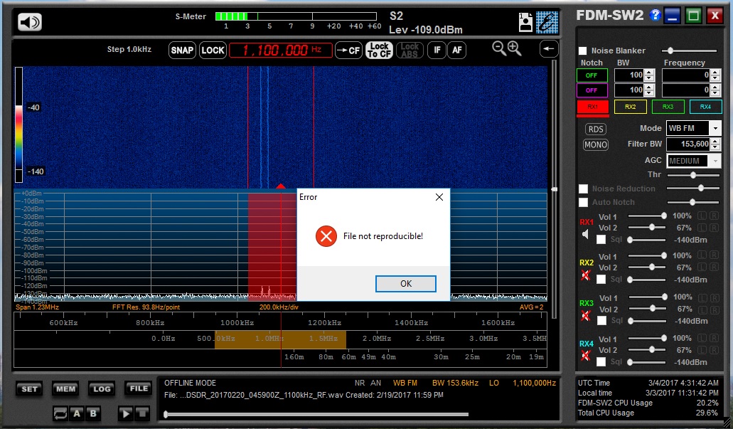

>What I found interesting is that with HDSDR, I could play back
>captures made either with the FDM-SW2 program or HDSDR.
>FDM-SW2 plays its own captures OK (I'd send it back if it didn't)
>but if I tried to use it to play the files I'd created with HDSDR, I
>got a "crab message" = File Not Reproducible.
>See:http://www.qsl.net/wa1ion/pictures1/elad_crab_message1.jpg
