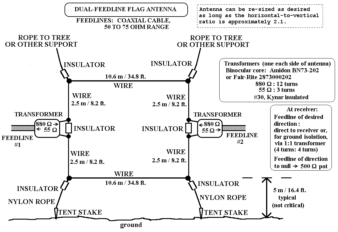

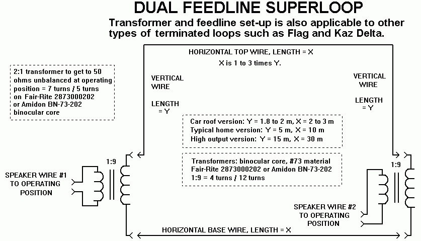

Even an ordinary SuperLoop, Flag, or Kaz should be able to dump WTAM down to nothing.
I'm a similar distance from WTAM in the opposite direction.  SuperLoop nulling 255 deg. / peaking 75 deg. largely clobbers WTAM to leave two co-channel Colombians, a Cuban, and Radio Globo from Brazil.  TA's such as Spain 1098 are helped.  If I moved the antenna to null at 270 deg. (due west), I'd scrape up another 5 or so dB or WTAM nulling.
These antennas are not hard to build and need less amplification than the DKAZ.
http://www.bamlog.com/superloop.htm
http://www.bamlog.com/vartermloop.htm
http://www.bamlog.com/flag.htm
http://www.qsl.net/wa1ion/pictures1/dual_feedline_superloop.gif
http://www.qsl.net/wa1ion/pictures1/dual_feedline_flag_antenna.gif
http://www.qsl.net/wa1ion/pictures1/dual_coax_feedline_flag_antenna.gif
